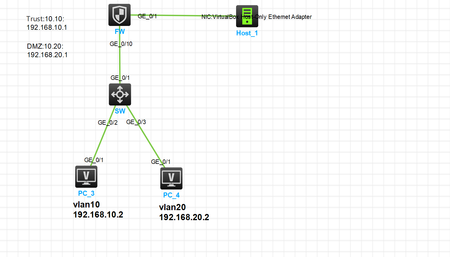

在防火墙物理接口10下面,新建两个子接口分别是10.10和10.20
10.10这个子接口的IP是192.168.10.1 安全域Trust
10.20这个子接口的IP是192.168.20.1 安全域DMZ
两台PC分别在不同的安全域

两个子接口终结各自的vlan了吗?,交换机上联口trunk放通vlan10跟20了吗?
可以了
忙呀忙呀忙 发表时间:2025-01-17 更多>>
求教!终结各自vlan怎么配置? 防火墙FW: interface GigabitEthernet1/0/10.10 ip address 192.168.10.1 255.255.255.0 interface GigabitEthernet1/0/10.20 ip address 192.168.20.1 255.255.255.0 security-zone name Trust import interface GigabitEthernet1/0/10.10 security-zone name DMZ import interface GigabitEthernet1/0/10.20 security-policy ip rule 0 name PolicyV4_0 action pass source-zone Trust destination-zone Local rule 1 name PolicyV4_1 action pass source-zone DMZ destination-zone Local rule 2 name PolicyV4_2 action pass source-zone Local destination-zone Trust rule 3 name PolicyV4_3 action pass source-zone Local destination-zone DMZ 交换机SW: vlan 10 vlan 20 interface GigabitEthernet1/0/1 port link-mode bridge port link-type trunk undo port trunk permit vlan 1 port trunk permit vlan 10 20 combo enable fiber interface GigabitEthernet1/0/2 port link-mode bridge port access vlan 10 combo enable fiber interface GigabitEthernet1/0/3 port link-mode bridge port access vlan 20 combo enable fiber

vlan-type dot1q vid 20
vlan-type dot1q vid 10
