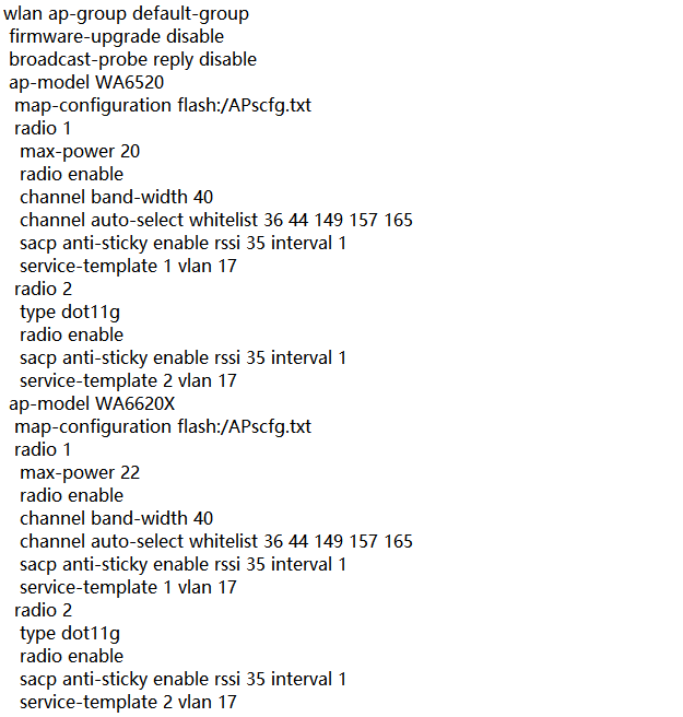

wlan ap-group default-group firmware-upgrade disable broadcast-probe reply disable ap-model WA6520 map-configuration flash:/APscfg.txt radio 1 max-power 20 radio enable channel band-width 40 channel auto-select whitelist 36 44 149 157 165 sacp anti-sticky enable rssi 35 interval 1 service-template 1 vlan 17 radio 2 type dot11g radio enable sacp anti-sticky enable rssi 35 interval 1 service-template 2 vlan 17 ap-model WA6620X map-configuration flash:/APscfg.txt radio 1 max-power 22 radio enable channel band-width 40 channel auto-select whitelist 36 44 149 157 165 sacp anti-sticky enable rssi 35 interval 1 service-template 1 vlan 17 radio 2 type dot11g radio enable sacp anti-sticky enable rssi 35 interval 1 service-template 2 vlan 17 # 信道和功率都手动调整过
清栩 发表时间:2025-06-26 更多>>
清栩 发表时间:2025-06-26
清栩 二段
信道和功率都有调整过
优化内容参考我修改过的配置
z6Kl9 发表时间:2025-06-26 更多>>
优化内容参考我修改过的配置
