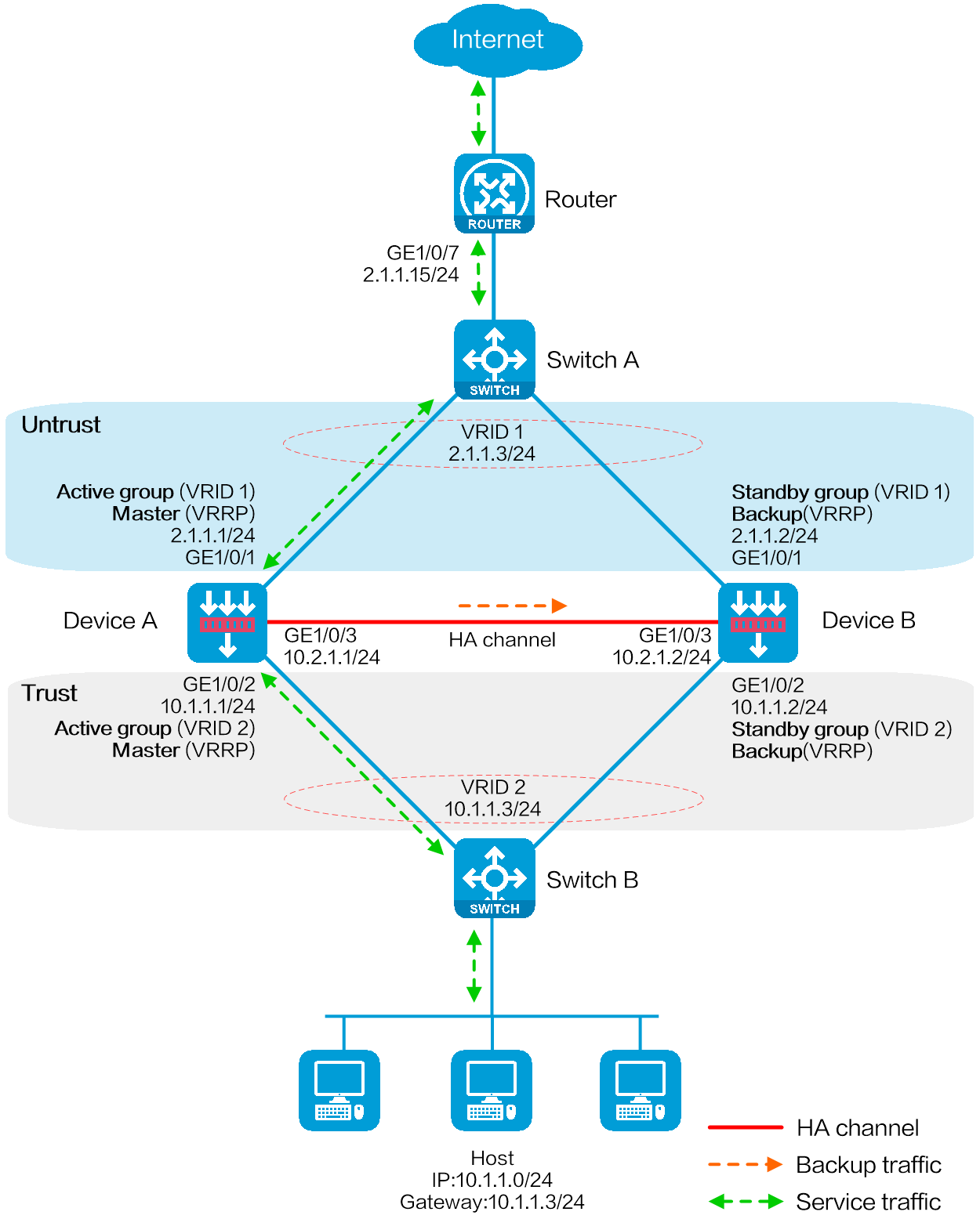

两台M9000X06进行RBM主备组网,目前只有单出口,只有一个公网地址。
可以在出接口下做snat和dnat吧?(两台设备同接口配置一样的地址和nat进行冷备),再开启会话引流,这样没问题吧?
可以做nat
建议vrrp方式做,参考:
HA联动VRRP主备模式中接口NAT功能典型配置

组网需求
如下图所示,某公司以Device作为网络边界安全防护设备,连接公司内部网络和Internet。为提高业务稳定性,使用两台Device进行HA组网,Device A作为主设备,Device B作为备设备。当Device A或其链路发生故障时,由Device B接替Device A继续工作,保证业务不中断。同时需要在Device上配置动态NAT功能保证内网用户可以访问Internet,该公司拥有2.1.1.1到2.1.1.10十个外网IPv4地址。
图-1 HA联动VRRP主备模式中接口NAT功能组网图

  • DeviceA
nat address-group 1
 address 2.1.1.5 2.1.1.10
 vrrp vrid 1
 port link-mode route
 ip address 2.1.1.1 255.255.255.0
 vrrp vrid 1 virtual-ip 2.1.1.3 active
 nat outbound address-group 1
 vrrp vrid 2 virtual-ip 10.1.1.3 active
 ip address 10.2.1.1 255.255.255.0
security-zone name Trust
 import interface GigabitEthernet1/0/2
security-zone name Untrust
 import interface GigabitEthernet1/0/1
 ip route-static 0.0.0.0 0 2.1.1.15
security-policy ip
 rule 0 name trust-untrust
  action pass
  source-zone trust
  destination-zone untrust
  source-ip-subnet 10.1.1.0 255.255.255.0
 rule 1 name vrrp1
  action pass
  source-zone trust
  destination-zone local
  service vrrp
 rule 2 name vrrp2
  action pass
  source-zone local
  destination-zone trust
  service vrrp
 rule 3 name vrrp3
  action pass
  source-zone untrust
  service vrrp
 rule 4 name vrrp4
  action pass
  source-zone local
  service vrrp
remote-backup group
 data-channel interface GigabitEthernet1/0/3
 configuration sync-check interval 12
 local-ip 10.2.1.1
 remote-ip 10.2.1.2
 device-role primary
  • DeviceB
 ip address 2.1.1.2 255.255.255.0
 vrrp vrid 1 virtual-ip 2.1.1.3 standby
 ip address 10.1.1.2 255.255.255.0
 vrrp vrid 2 virtual-ip 10.1.1.3 standby
 ip address 10.2.1.2 255.255.255.0
remote-backup group
 local-ip 10.2.1.2
 remote-ip 10.2.1.1
 device-role secondary
