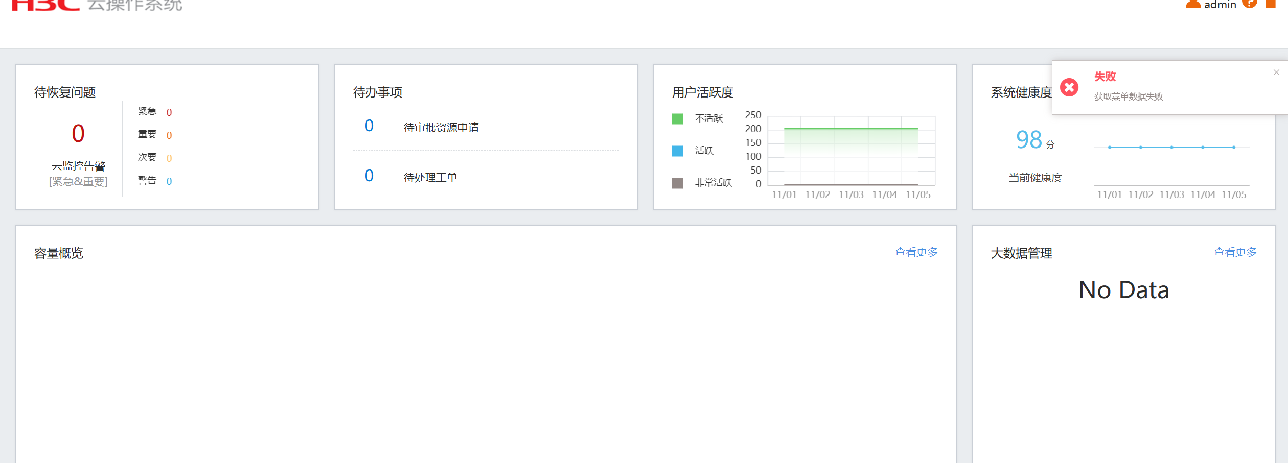

CLOUDOS3.0前台界面空白,master节点满了,重定向后pod起来前台还是不行
2025-11-05提问
  • 0收藏,1618浏览
空白的,原来是gnocchi_wsgo_error.log占满空间了,echo >后,pod都起来了,没起来的都delete起来了,但是现在还是显示空白--,这个怎么处理呀。rabbit已经重启好几次了,kinton也重启了--
有个rabbit报错,在故障节点上。Error syncing pod, skipping: failed to "StartContainer" for "rabbit1" with CrashLoopBackOff: "Back-off 10s restarting failed cOntainer=rabbit1 pod=rabbit1rc-qdd6n_default(4d4b9b2c-ba2f-11f0-9b26-c2ab20da4d30)"
6m 6m 1 kubelet, 19.202.189.135 spec.containers{rabbit1} Normal Created Created container with id 54b2d39397b1402ad2c17268f165107d166e4a90f364990273dda4d6e4b73547
6m 6m 1 kubelet, 19.202.189.135 spec.containers{rabbit1} Normal Started Started container with id 54b2d39397b1402ad2c17268f165107d166e4a90f364990273dda4d6e4b73547
5m 5m 2 kubelet, 19.202.189.135 Warning FailedSync Error syncing pod, skipping: failed to "StartContainer" for "rabbit1" with CrashLoopBackOff: "Back-off 20s restarting failed cOntainer=rabbit1 pod=rabbit1rc-qdd6n_default(4d4b9b2c-ba2f-11f0-9b26-c2ab20da4d30)"
5m 5m 1 kubelet, 19.202.189.135 spec.containers{rabbit1} Normal Created Created container with id b176f9c230cb784c3b152dfeef7aff2cc2b08f7285b7db5bc822a81a3729ce7d
5m 5m 1 kubelet, 19.202.189.135 spec.containers{rabbit1} Normal Started Started container with id b176f9c230cb784c3b152dfeef7aff2cc2b08f7285b7db5bc822a81a3729ce7d
4m 4m 3 kubelet, 19.202.189.135 Warning FailedSync Error syncing pod, skipping: failed to "StartContainer" for "rabbit1" with CrashLoopBackOff: "Back-off 40s restarting failed cOntainer=rabbit1 pod=rabbit1rc-qdd6n_default(4d4b9b2c-ba2f-11f0-9b26-c2ab20da4d30)"
3m 3m 1 kubelet, 19.202.189.135 spec.containers{rabbit1} Normal Started Started container with id f970427bcb7b8a49afe565a6a2abb1590f3a92f2069eff4268e55caca53cab50
3m 3m 1 kubelet, 19.202.189.135 spec.containers{rabbit1} Normal Created Created container with id f970427bcb7b8a49afe565a6a2abb1590f3a92f2069eff4268e55caca53cab50
3m 2m 6 kubelet, 19.202.189.135 Warning FailedSync Error syncing pod, skipping: failed to "StartContainer" for "rabbit1" with CrashLoopBackOff: "Back-off 1m20s restarting failed cOntainer=rabbit1 pod=rabbit1rc-qdd6n_default(4d4b9b2c-ba2f-11f0-9b26-c2ab20da4d30)"
7m 1m 6 kubelet, 19.202.189.135 spec.containers{rabbit1} Normal Pulled Container image "cloud-base/rabbitmq-3.6.5:E3106H01-V300R001B01D029-RC3" already present on machine
1m 1m 1 kubelet, 19.202.189.135 spec.containers{rabbit1} Normal Created Created container with id 69d01cbf2521a80ead1b75b07ae91f1d0d6621e0b3c41c57b0f5339608deab44
1m 1m 1 kubelet, 19.202.189.135 spec.containers{rabbit1} Normal Started Started container with id 69d01cbf2521a80ead1b75b07ae91f1d0d6621e0b3c41c57b0f5339608deab44
6m 3s 20 kubelet, 19.202.189.135 spec.containers{rabbit1} Warning BackOff Back-off restarting failed container
1m 3s 7 kubelet, 19.202.189.135 Warning FailedSync Error syncing pod, skipping: failed to "StartContainer" for "rabbit1" with CrashLoopBackOff: "Back-off 2m40s restarting failed cOntainer=rabbit1 pod=rabbit1rc-qdd6n_default(4d4b9b2c-ba2f-11f0-9b26-c2ab20da4d30)"

sorb-rc-jrpsf 这个是什么组件,这个也是一样状态--
zhiliao_bcnO3f 发表时间:2025-11-06 更多>>
