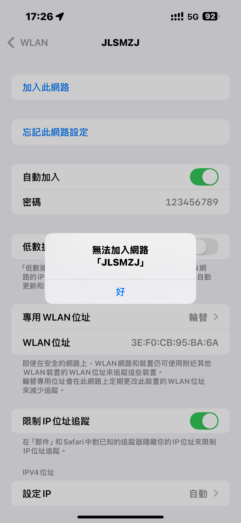

连接无线一直显示无法连接网络是怎么回事

贴一下AC的配置看看,大概率是配置问题

# version 7.1.064, Release 5822P07 # sysname WX-AC # clock timezone Beijing add 08:00:00 clock protocol ntp # wlan global-configuration firmware-upgrade disable calibrate-channel self-decisive enable all calibrate-power self-decisive enable all # telnet server enable # dot1x authentication-method eap dot1x retry 10 dot1x timer supp-timeout 2 dot1x timer tx-period 2 # dhcp enable # dns proxy enable ip host quicknet.h3c.com 192.168.0.100 ip host wlan.h3c.com 192.168.0.100 dns fast-reply enable # lldp global enable # vlan 1 # vlan 99 to 100 # vlan 200 # vlan 1099 to 1100 # vlan 2099 # vlan 4094 # dhcp server ip-pool 1 gateway-list 192.168.0.100 network 192.168.0.0 mask 255.255.255.0 dns-list 192.168.0.100 # dhcp server ip-pool 1099 gateway-list 197.10.10.254 network 197.10.10.0 mask 255.255.255.0 address range 197.10.10.10 197.10.10.250 dns-list 197.10.10.254 223.5.5.5 # dhcp server ip-pool 1100 gateway-list 197.10.20.254 network 197.10.20.0 mask 255.255.255.0 address range 197.10.20.10 197.10.20.250 dns-list 197.10.20.254 223.5.5.5 # dhcp server ip-pool 2099 gateway-list 198.0.0.1 network 198.0.0.0 mask 255.255.254.0 address range 198.0.0.10 198.0.1.250 dns-list 198.0.0.1 223.5.5.5 # dhcp server ip-pool 4094 gateway-list 10.40.94.1 network 10.40.92.0 mask 255.255.252.0 dns-list 10.40.94.1 # wlan service-template 1 ssid JLSMZJ vlan 1100 akm mode psk preshared-key pass-phrase cipher $c$3$AIKReUXVCeACUneNQgkNSsCwwy8cy6JykbowgQ== cipher-suite ccmp cipher-suite tkip security-ie rsn security-ie wpa bss transition-management enable service-template enable # interface NULL0 # interface Vlan-interface1 ip address 192.168.0.100 255.255.255.0 # interface Vlan-interface1099 ip address 197.10.10.254 255.255.255.0 # interface Vlan-interface1100 ip address 197.10.20.254 255.255.255.0 # interface Vlan-interface2099 ip address 198.0.0.1 255.255.254.0 # interface Vlan-interface4094 ip address 10.40.94.1 255.255.252.0 dhcp server apply ip-pool 4094 # interface GigabitEthernet1/0/7 port link-mode route ip address dhcp-alloc undo dhcp select server # interface GigabitEthernet1/0/8 port link-mode route description SingleAutonet_Line1 ip address 183.94.86.40 255.255.255.128 dns server 218.104.111.114 dns server 218.104.111.122 tcp mss 1398 nat outbound undo dhcp select server # interface GigabitEthernet1/0/1 port link-mode bridge port access vlan 1099 # interface GigabitEthernet1/0/2 port link-mode bridge port access vlan 1099 # interface GigabitEthernet1/0/3 port link-mode bridge # interface GigabitEthernet1/0/4 port link-mode bridge # interface GigabitEthernet1/0/5 port link-mode bridge # interface GigabitEthernet1/0/6 port link-mode bridge port link-type trunk port trunk permit vlan all port trunk pvid vlan 1099 # interface Ten-GigabitEthernet1/0/9 port link-mode bridge # interface Ten-GigabitEthernet1/0/10 port link-mode bridge # scheduler logfile size 16 # line class console user-role network-admin # line class vty user-role network-operator # line con 0 user-role network-admin # line vty 0 31 authentication-mode scheme user-role network-operator # ip route-static 0.0.0.0 0 GigabitEthernet1/0/8 183.94.86.1 preference 70 # undo info-center logfile enable info-center source STAMGR console deny info-center source STAMGR logbuffer deny # snmp-agent snmp-agent local-engineid 800063A2809C09719F412000000001 snmp-agent sys-info version v3 # ssh server enable # time-range _SYS_RRM_TimeRange 00:00 to 23:59 daily # ntp-service enable ntp-service refclock-master 6 ntp-service unicast-server ***.*** minpoll 1 maxpoll 1 ntp-service unicast-server ***.*** minpoll 1 maxpoll 1 ntp-service unicast-server ***.*** minpoll 1 maxpoll 1 ntp-service unicast-server registry.h3c.com minpoll 1 maxpoll 1 ntp-service unicast-server ***.*** minpoll 1 maxpoll 1 # domain system # domain default enable system # role name level-0 description Predefined level-0 role # role name level-1 description Predefined level-1 role # role name level-2 description Predefined level-2 role # role name level-3 description Predefined level-3 role # role name level-4 description Predefined level-4 role # role name level-5 description Predefined level-5 role # role name level-6 description Predefined level-6 role # role name level-7 description Predefined level-7 role # role name level-8 description Predefined level-8 role # role name level-9 description Predefined level-9 role # role name level-10 description Predefined level-10 role # role name level-11 description Predefined level-11 role # role name level-12 description Predefined level-12 role # role name level-13 description Predefined level-13 role # role name level-14 description Predefined level-14 role # user-group system # local-user admin class manage password hash $h$6$7M4jjWfA3h8HirIs$OOjlo57H/0hm3G6kY/uMIWiBVxljC0Pxp4lkejLeQBbAuWtBU/GvG7iT5pqJx5N41RJ1Ztw/OiC6nWnOGeuTwA== service-type ftp service-type ssh telnet http https authorization-attribute user-role network-admin # ftp server enable # undo portal host-check enable # netconf soap http enable netconf ssh server enable # ip http enable ip https enable # smartmc enable smartmc password cipher $c$3$zJWhmOEVRU4FSvmloYfXhbMIGOanwEAMnnHXyqM= # wlan auto-ap enable wlan auto-persistent enable wlan tcp mss 1360 # wlan ap-group default-group firmware-upgrade disable vlan 1 radio 2.4g radio enable service-template 1 radio 5g radio enable service-template 1 radio 6g ap-model WA6520S-D radio 1 radio enable radio 2 radio enable gigabitethernet 1 ap-model WA6520S-E radio 1 radio enable radio 2 radio enable gigabitethernet 1 # wlan ap-group default-ponapgroup type pon vlan 1 # wlan virtual-ap-group default-virtualapgroup radio 2.4g radio 5g # wlan ap 7c7a-3c29-5760 model WA6520S-D serial-id 219801A48B8232E000ZK vlan 1 radio 1 service-template 1 radio 2 service-template 1 gigabitethernet 1 # wlan ap 7c7a-3c29-6400 model WA6520S-D serial-id 219801A48B8232E00162 vlan 1 radio 1 service-template 1 radio 2 service-template 1 gigabitethernet 1 # wlan ap 7c7a-3c29-6500 model WA6520S-D serial-id 219801A48B8232E0016L vlan 1 radio 1 service-template 1 radio 2 service-template 1 gigabitethernet 1 # wlan ap 7c7a-3c29-6800 model WA6520S-D serial-id 219801A48B8232E00184 vlan 1 radio 1 service-template 1 radio 2 service-template 1 gigabitethernet 1 # wlan ap 7c7a-3c29-6920 model WA6520S-D serial-id 219801A48B8232E0018Q vlan 1 radio 1 service-template 1 radio 2 service-template 1 gigabitethernet 1 # wlan ap 7c7a-3c29-5f30 model WA6520S-D serial-id 219801A48B8232E0013L vlan 1 radio 1 service-template 1 radio 2 service-template 1 gigabitethernet 1 # wlan ap 7c7a-3c29-60c0 model WA6520S-D serial-id 219801A48B8232E0014D vlan 1 radio 1 service-template 1 radio 2 service-template 1 gigabitethernet 1 # wlan ap 7c7a-3c29-61f0 model WA6520S-D serial-id 219801A48B8232E00150 vlan 1 radio 1 service-template 1 radio 2 service-template 1 gigabitethernet 1 # wlan ap 7c7a-3c29-6b50 model WA6520S-D serial-id 219801A48B8232E0019V vlan 1 radio 1 service-template 1 radio 2 service-template 1 gigabitethernet 1 # wlan ap 7c7a-3c29-6bb0 model WA6520S-D serial-id 219801A48B8232E001B1 vlan 1 radio 1 service-template 1 radio 2 service-template 1 gigabitethernet 1 # wlan ap 7c7a-3c29-6f10 model WA6520S-D serial-id 219801A48B8232E001CS vlan 1 radio 1 service-template 1 radio 2 service-template 1 gigabitethernet 1 # autonet enable # cloud-management server domain cloudnet.h3c.com # return
zhiliao_GgOy8J 发表时间:2026-01-07
看了一下你发的配置文件,先在服务模板1不加密看看能不能正常连接上和正常获取到地址,不能获取到的话,在interface Vlan-interface1100 里面加上dhcp server apply ip-pool 1100

检查DHCP服务器是否正常,及射频配置是否正常
