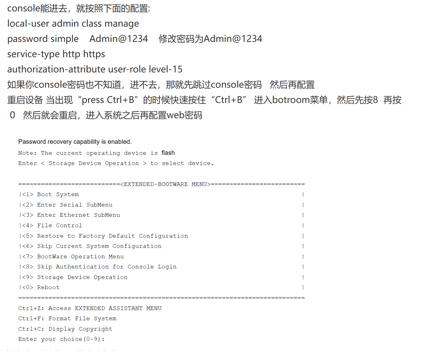

Console口登录修改下密码
<H3C>system-view
[H3C]local-user admin
[H3C-luser-admin]password simple 123456    //修改密码为123456
[H3C-luser-admin]quit
那就需要用console线重启,跟进提示按ctrl+B进入bootroom菜单,然后跳过console口验证选项

就是console口账号密码忘记了,登不进去
哈哥无敌了 发表时间:2026-01-24
xiaoyu 发表时间:2026-01-24
3.1 进入bootroom菜单清除Consle密码
通过conlse线和crt软件连接并登陆设备,然后把设备断电重启。控制台上会打印如下信息,当出现“press Ctrl+B”的时候快速按住“Ctrl+B” 进入botroom菜单

      按住“Ctrl+B”进入如下菜单。选择“<6> Skip Current System Configuration”跳过当前配置启动,不同设备可能不是数字6,
===========================<EXTEND-BOOTWARE MENU>===========================
|<1> Boot System                                                           |
|<2> Enter Serial SubMenu                                                  |
|<3> Enter Ethernet SubMenu                                                |
|<4> File Control                                                          |
|<5> Restore to Factory Default Configuration                              |
|<6> Skip Current System Configuration                                     |
|<7> BootWare Operation Menu                                               |
|<8> Clear Super Password                                                  |
|<9> Storage Device Operation                                              |
|<0> Reboot                                                                |
Ctrl+Z: Access EXTEND-ASSISTANT MENU
Ctrl+F: Format File System
Enter your choice(0-9): 6
Flag Set Success.
然后输入0重启设备
