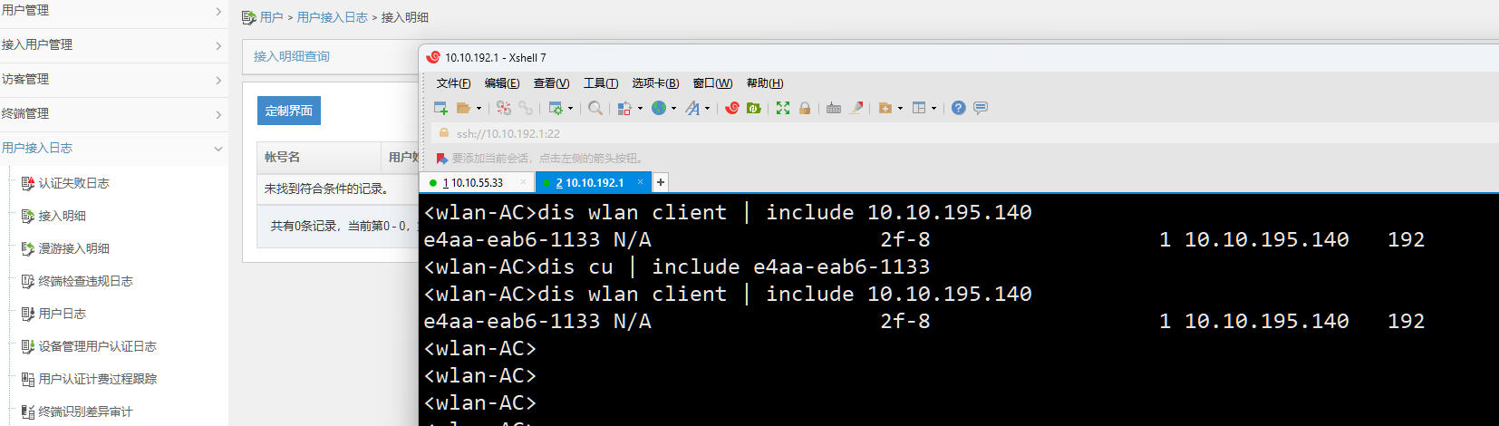

imc7.3在用户接入日志-接入明细中,找不到一个终端的接入明细,不知是什么原因?在ac上可以看到终端在线信息,如何查找这个终端对应的用户信息呢?
请问如何查找这个终端对应的用户账号信息呢?

<wlan-AC>dis wlan client | include 10.10.195.140 e4aa-eab6-1133 N/A 2f-8 1 10.10.195.140 192 <wlan-AC>dis portal user all | include 10.10.195.140 <wlan-AC>

display connection ,AC上没有这个命令
小叶 发表时间:2026-01-29
<wlan-AC>display wlan client mac-address e4aa-eab6-1133 verbose Total number of clients: 1 MAC address : e4aa-eab6-1133 IPv4 address : 10.10.195.140 IPv6 address : N/A Username : N/A AID : 33 AP ID : 110 AP name : 2f-8 Radio ID : 1 Channel : 149 SSID : HN0601 BSSID : 9c06-1b53-b463 VLAN ID : 192 Service VLAN ID : N/A Sleep count : 26 Wireless mode : 802.11ac Channel bandwidth : 80MHz SM power save : Disabled Short GI for 20MHz : Supported Short GI for 40MHz : Supported Short GI for 80MHz : Supported Short GI for 160/80+80MHz : Not supported STBC RX capability : Supported STBC TX capability : Not supported LDPC RX capability : Supported Beamformee STS capability : N/A Number of Sounding Dimensions : N/A SU beamformee capability : Not supported MU beamformee capability : Not supported Block Ack : TID 0 Both TID 1 Out TID 6 In Supported VHT-MCS set : NSS1 0, 1, 2, 3, 4, 5, 6, 7, 8, 9 Supported HT MCS set : 0, 1, 2, 3, 4, 5, 6, 7 Supported rates : 12, 18, 24, 36, 48, 54 Mbps QoS mode : WMM Listen interval : 1 RSSI : 28 Rx/Tx rate : 390/325 Mbps Speed : 4.280/8.280Kbps Authentication method : Open system Security mode : RSN AKM mode : PSK Cipher suite : CCMP User authentication mode : Bypass WPA3 status : Disabled SAE PWE Method : None Authorization CAR : N/A Authorization user group name : N/A Authorization ACL ID : N/A Authorization user profile : N/A Roam status : N/A Key derivation : SHA1 PMF status : N/A Forwarding policy name : Not configured Online time : 1days 23hours 51minutes 27seconds FT status : Inactive BTM mode : Inactive 这个是终端的完整信息
小叶 发表时间:2026-01-30
就是找不到这个终端对应在IMC上的哪个用户
小叶 发表时间:2026-01-30
用户通过MAC自动认证,这个是怎么看的?imc上好像没配置这个。portal免认证的列表里也没有这个mac地址。
小叶 发表时间:2026-01-30
小叶 发表时间:2026-01-30
做的什么认证,这个是认证通过的终端吗?
portal认证,其他终端都有记录,就这个特殊,查不到任何记录
小叶 发表时间:2026-01-29 更多>>
小叶 发表时间:2026-01-29
