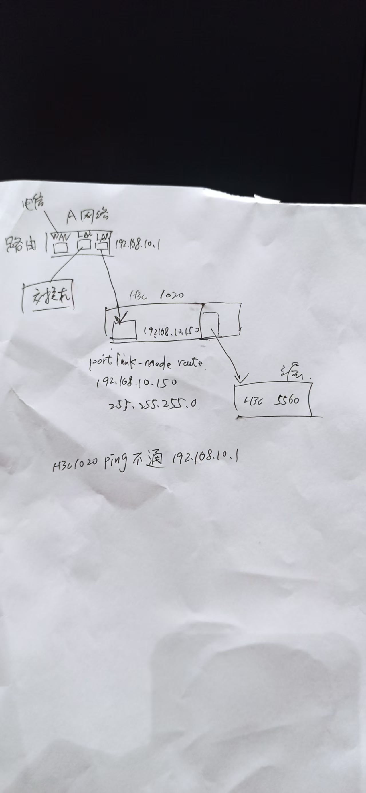

H3C 1020端口设置了固定IPinterface GigabitEthernet1/0/13
 port link-mode route
 ip address 192.168.10.180 255.255.255.0
电脑也设置了IP192.168.10.150同一网段接到交换机,为何电脑ping不通H3C 1020端口ip address 192.168.10.180呢
